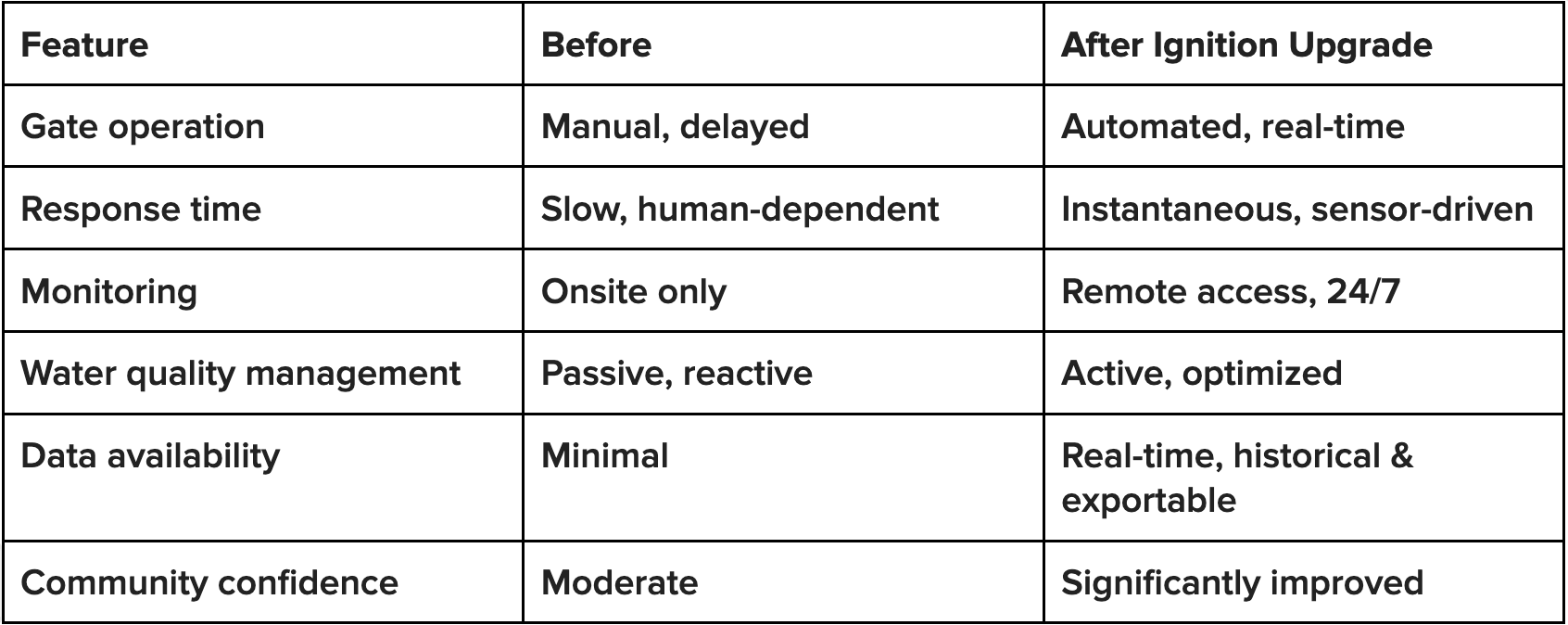

Result
Key Benefits:
1. Improved Flood Protection:
Before: Delays with manual gate operation increased the flooding risk.
After: Automated controls respond quickly to real-time water levels and tides, ensuring faster flood mitigation.
2. Enhanced Water Quality:
Before: Poor water exchange caused stagnation and algae.
After: Optimized gate operations improve water quality and support aquatic life.
3. Remote Monitoring and Control:
Before: Operators needed to be on-site for control.
After: Web-based SCADA allows remote system management, improving response times.
4. Reduced Maintenance Costs:
Before: Frequent manual checks led to high operational costs.
After: Automation reduces manual workload and enables proactive maintenance.
Unexpected Benefits:
  • Data-Driven Insights: Real-time data supports better decision-making and planning.
  • Public Confidence: Increased transparency and community trust in the system.
  • Adaptability to Future Events: Ignition’s flexibility has helped manage abnormal weather conditions effectively.
Before vs. After
