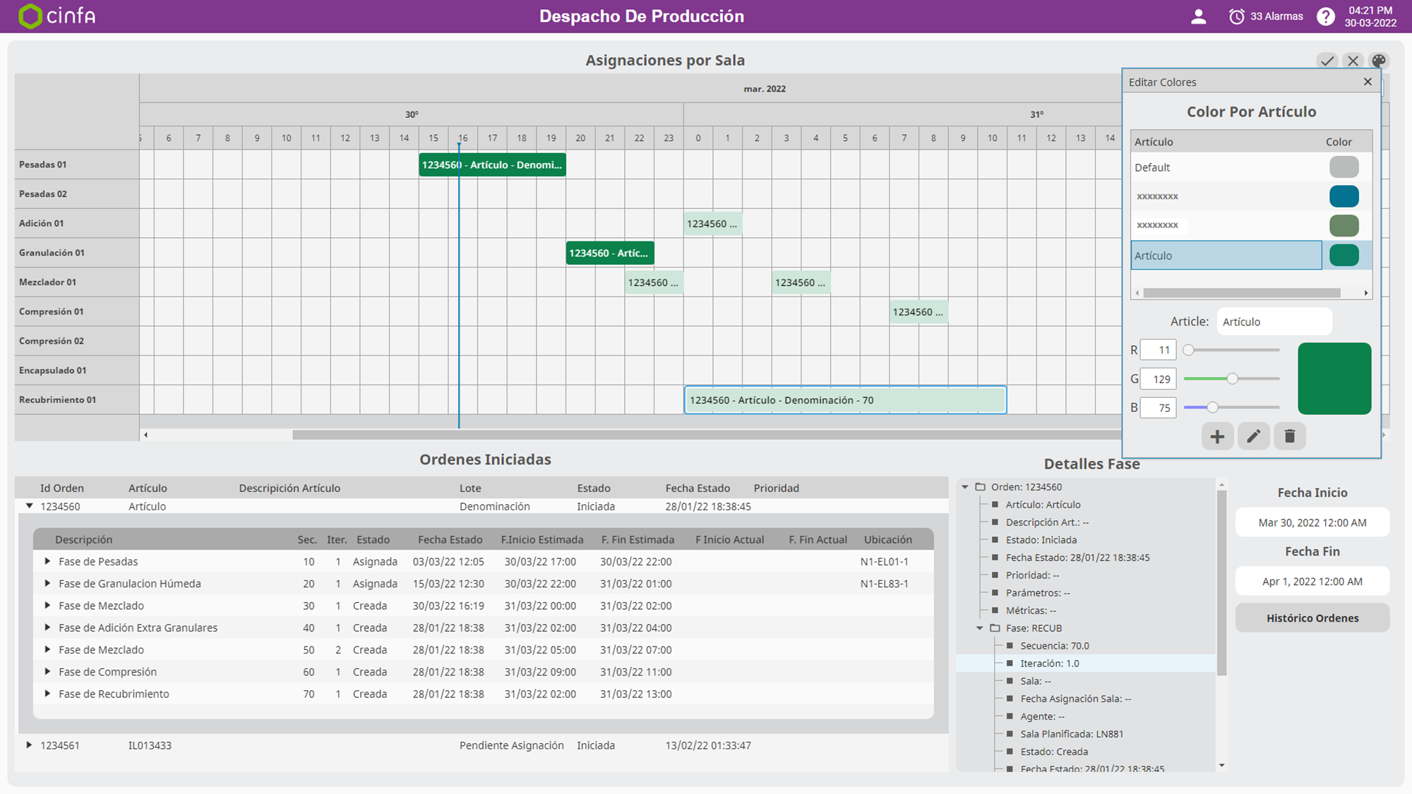

List of UI developed, using both Perspective and Vision:
  1. Perspective workstations: 14 UIs to monitor all production processes in the different areas. SCADA functionalities and clean room conditions using tables.
  2. Vision clients: six UIs to monitor all climate conditions of clean rooms and eight UIs to monitor the different production areas.
